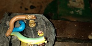

I have always mainly used my supplied granny charger , because at work I can plug it in a couple of times a week for the whole day for free , but I have noticed recently that the 3 pin plug after a day's charge has been getting hotter than before to the point that the metal pins are too hot to touch after unplugging. I know that other forum members have mentioned about changing the 3 pin plug , which I decided to do with a heavy duty one (still very tight to fit the wires in) charged the next day for around 7 hrs , unplugged and found the new plug was not even warm 🙂 , so I cut the original plug open and found the live wire to be crimped in place and not even crimped that tight it was very easy to pull out , so I do recommend to change the plug if other users feel the 3 pin plug is hotter than they expect after a long charge and if the granny charger is what they use most of the time 👍

Is there not a thermal sensor in the plug?

Hi , not that I found I would imagine that if there is any type of thermal sensor it would be in the main body of the charger it's self.

I just wanted to add that I changed my 3 pin plug on the granny charger because it was a lot hotter after 18 months of use than when I first bought the car and at the moment it is my main source for charging the car , please only change the plug if you feel yours has similar problems and also that you are confident to do it in a safe manner and also it may void your warranty on the unit 👍
