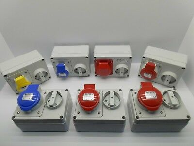

Ask to have one of these installed

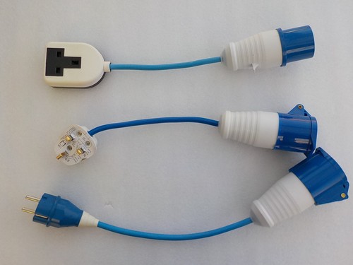

And buy one of these so that you can use your granny charger

Another option is to get a quote from local electrician to fit you a switched 32amp commando lead and plug in an ohme smart charger with commando plug. That way you can take it with you when you move.
Octopus energy are doing them for £199
Next cheapest I've seen them is from Romatech.

I have the 32 amp socket installed. (I picked up a new Ohme cable via ebay).
This was put in after I had a 13 amp socket installed.
Just one point from your post - I think the 16 and 32 amp connectors are different sizes, so you cannot use a caravan socket adapter with the 32 amp socket.
(The fusing would not be correct as well).
