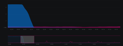

Assuming you can see the attached graph from the Zappi it had started reducing the current at 03.10 and was still going at 04.30 (finished at 04.35) which is way longer than I have seen before. It had been balanced on a 7kW charger about 10 days before so it's not like it had been a long time since the last balance.

The Zappi knows nothing about balancing and cares nothing about it. It simply supplies the desired charge level until the car says "I'm finished" and this won't be issued by the car until balancing is complete.
So with connection to IOG via Zappi/Ohme/Wallbox balancing is automatic so long as the requested +N% amount is enough to cover the balancing.
With a direct connection between IOG and the car, balancing has been a problem because once the car hits the target percentage (eg 100%), the charge is ended.
For these cases, people have been using the Bump Charge capability to balance, since this uses minimal energy and will terminate when the car says it is finished. It doesn't matter if this is at the higher rate since very little energy is needed to balance.
Not ever seen that. Again today my car balanced for 35 min on the Zappi from direct solar, so it seems to be possible and I can stop worrying that that won't happen. I think the problem may be if for some reason there's no excess the trickle charge will stop and not start again. I don't think I've ever left the car for as long as 10 days without balancing though.
