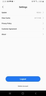

Thanks for your help. I did find the option to login. It was on the "smiley face" section of the app but you then have to select "settings". After selecting settings it presents you with the Login Hello! Welcome to MG
However, I wasn't able to login successfully. I tried to use the facility of using the "Forgot Password" and indeed it does send a validation code to my phone to allow me to input a new password and to confirm it, but it never allows me to login. When I input a new password and repeat this password as a confirmation it "greys out" the login button, thus preventing me to attempt a login.
Does the password have to meet a specific criteria to be allowable? Maybe the passwords I choose do not meet the requirements?
Also, I used my mobile phone number as the login name. In desperation I also tried my email address. On all occasions.....I failed.
Ok, I persisted with this and found out that the password criterion is 8 to 15 (I think it was 15) alphanumeric characters. I used a password containing only numbers and letters (total of 9 characters). Two of the letters were uppercase. This seemed to be acceptable and it seemed to allow me to select the login button. See the attached screenshot, which suggests I am logged in, but it still wants me to bind to the car. Very frustrating.
