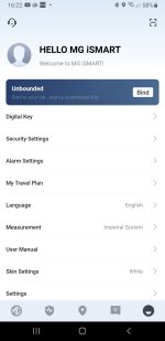

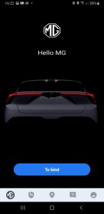

I have provided two sceenshots from the MG iSMART app to show the situation I find myself. It only gives me the option "To bind". In the second attachment it tells be that it's "Unbounded" and advises me to "Bind to your car, start a customized trip". I don't see an option to just login. Can you help?
You need to logout* first, and then log back in with the very first details you used when creating your account. (I'm assuming that you've previously been able to see your car in the app, before the app updated).
* In the app, click the "face" icon on the right then click the big blue Logout button at the bottom.
Which car do you have? Does the car give you any info about it being bound to an account? Can you see any user account name/details in the car screen?
