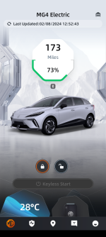

And you correctly pressed the keyless start button after ensuring the Bluetooth is connected?
And in the latest version of the app you calibrated Bluetooth?
And the digital key is there?
Have you tried to unbind the app and then binding to the car again?
