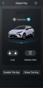

OK. so when you go into the app under your profile then select digital key. Has a digital key been generated and protected by your user PIN number? i.e are you even able to get that far in the app. If this has been done then the keyless start option wont even be selectable in the app. What errors at which stage of digital key setup or usage are you getting in the app?

Just checked and my DK works - Moto g8 power/android 11.
In house, key fobs in Faraday bags, Bluetooth not connected to car.
Opened app and approaching car pressed Unlock button on home page - no remote access so did a status scan and then unlock worked. Note no pin required!
Pressed 'Keyless Start', app said to sit in the car.
Sat in car with door open and 'Smart key not detected' shown. Waited for Bluetooth to connect but needed to press the info home button before a connection was made.
Closed door and 'Smart key' message disappeared. Pressed highlighted in blue 'Keyless Start' button and car went into ready mode.
Tried again. Bluetooth not connected.
Opened car from app home page. Sat in the seat. Smart key warning appeared. Waited for Bluetooth connection to appear on my phone. Did not appear. Pressed brake pedal and second warning appeared.
Pressed Keyless Start on app home page and driver's screen powered up with the usual warnings associated with a delayed info screen start. Waited for info screen to start but needed to press home button to start.
Once powered up the screen and my phone showed a Bluetooth connection.

It doesn't need the PIN if you have used it since opening the app. If you just press back to get out of the app or switch apps, it stays running in the background. Next time you go to the app no PIN is required.
Exit the app fully if you want to ensure the PIN is required next time.
This behaviour may have changed on the latest version, I haven't checked.
Might sound obvious but the keyless option won't work if the car is unlocked.. try this sequence.
1. Unlock the car using the app
2. Get in the car and lock using the app
3. Select the digital key under the profile option after first ensuring the app is indicating a Bluetooth connection has been succesfull.
Why not just unlock the vehicle using the digital key in the first place? That works fine.
It's slightly weird that the app provides two different ways to lock/unlock the vehicle - one is "in-app" and the other is the digital key, and they both work slightly differently. i.e. you can't lock the car using just the "app" functionality if you haven't shut it down first yet you can do this with the digital key.
Just another small way that you can tell this really hasn't been designed/tested particularly well.
