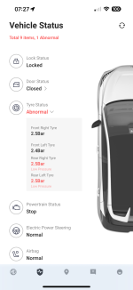

I am having the same issues, which only started after the car was in for service in May. I get rear warnings daily, every drive and they are at 2.4-2.5bar when I get the warnings. The fronts are the same pressure and no warnings.
If I still get the warnings when I get the car back from the garage I’ll stick them all at 2.6bar and see how I go.
Was interesting to me that I get a warning when the pressure is correct but only on the rears. I got the odd warning before service when it was cold, but since May I’d say there been maybe 4-5 days I haven’t had the warning. And it’s a daily drive to work car, not just a weekender.

I think this also might relate to the monitoring while stationary.
After you took that screenshot, did the warning disappear?
