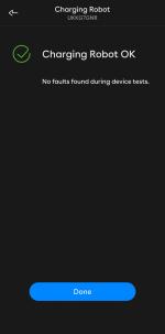

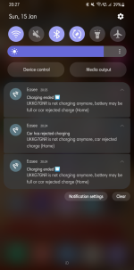

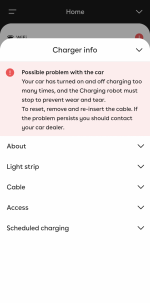

Some screenshots from today

I took this video of the charger and what it does (I've sped it up, that's not normal speed!!)
