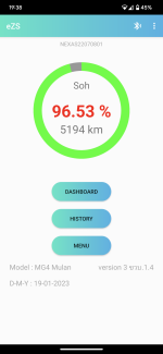

And I just checked battery today and it is 96.53%

Wow it makes it look like LFP really suck my MNC with 5300 miles (8529km) is still 100%
"Make it look" are the operational words, when if fact it is the opposite. Your software lies to you when it still gives 100%, ours lies to us when it shows SOH drop every day.
I guess we need to bring this issue to MG's attention, so they can fix their software. Any chance you could have a word with them @Miles Roberts CG ?

Only just saw your attachment. The measured values line up perfectly with my prediction: 22/12/23 to 15/1/23 are 24 days. Calculated decline in SOH: 24 * 0.0104% = 0.25%. Actual decline in SOH: 96.82% - 96.57% = 0.25%.
I assume you set the day you go the car to 100%, but didn't actually check SOH back then?
My calculation would go: 96.57% is a loss of 3.43%, equal to 330 days of linear decline. I'd put the production day of you battery pack at 19/02/2022.
