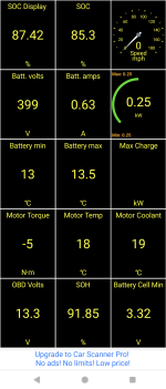

One odd thing I noticed this time when I plugged my cheap ODB reader - SoC showed 87% but the car was showing 67% on screen ... ?

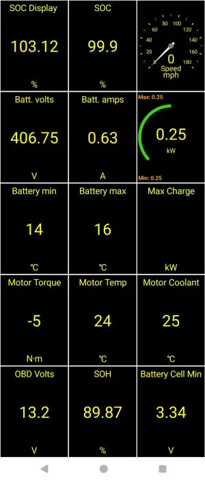

Hi,
What's your SOH today? Has the 0.01%/day loss stopped or continued?
This was on 29.03.2025
Let me know your calculations, I didn't count days... 🙂
Thank you for your quick response. Unfortunately, I see that the loss continues. We're really dealing with a purely software limitation.
I have a Standard MG4 with an LFP battery, and I notice this decrease every day, as well as with every excessive acceleration and every DC charge. I managed to raise the SOH by discharging the battery to 0% SOC BMS, but since the 2-year service, the BMS seems frozen and refuses to raise it.
Today, I'm at 94% SOH with 49,000 km and 25 months of use. My car was produced on 13/11/2022. Last year, I managed to raise the SOH several times by reaching 0% and then trickle charging to 100%, without interrupting the charge or connecting to the car.
