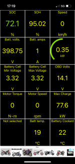

fellow perth dweller here. I bought a ‘new’ feb23 manufactured ZS excite in jan 24 for a discounted price. I didn’t have the knowledge to ask for SoH at the time. However this thread piqued my interest so I got myself a dongle and car scanner and tested the SoH today. 95% at 1.4yrs looks very similar to the linear degradation proposed by the OP, albeit a bit ‘better’ (calc 94.6%)
I have only used DC at 50kW once to get to 60%. Most other charging has been <4kW from solar with one 3p 11kW. Generally max charge to 80%- 90%. Balance charged once in 6 mths. 3800km mostly around town.

Update 30 days after my initial SOH interrogation:
95.02 to 94.71
Near as dammit to 0.3% drop but still maxing out at 320km range as it was in Jan. 4000km charged by solar AC 99%. Cells balanced once only. DC charged only once. Interesting that the system appears to show the DC charge taper. 77.6kW at 72.1% and 32.6kW at 91.8%
