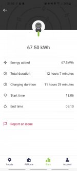

How can I tell how many actual kWh my MG4 can hold? Not what the specs say it should be, but what my MG5 actually is.
I could charge it from zero and use a meter to read the charge taken to reach 100%

I put this in yesterday.
