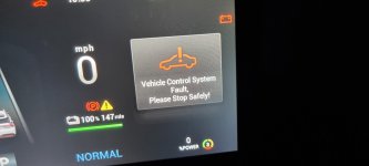

To make matters worse, when i took it off charge last yesterday i got a new warning stating "Vehicle control system failure, Please stop safely"
The car would not go in to drive and i was worried i would be walking home, i had to get out of the car, lock it and unlock it and the fault went away and i was able to drive home.
