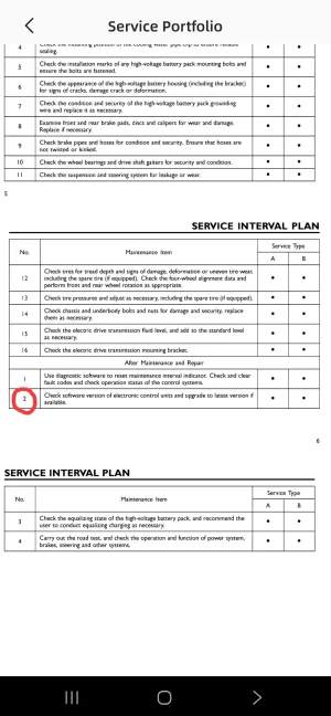

I don't know how ot works at Ukrain, but i just filed a lawsuit (it called "small lawsuit" without lawyer) against the MG official importer. Updates is mandatory by the manufacturer at every service.
You are in Israel, so different laws in your country.
Where is this information written? I understand that the dealer which is only the agent here in Germany must cover the updates costs or you pay them yourself. MG will only pay when it is a known an accepted issue.
There is a service portfolio at iSmart Europe with all the things that should be included at the service (Service A and service B) software updates is part of both of them.
This should be part of the service cost.
Its not something that the dealer have a "say". Its part of the official manufacturer service program in the EU.
