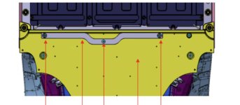

Mine doesn’t look like that, neither before nor after the bracket. So perhaps there has been a redesign? It appears to flare over a bolt, so maybe it’s not so much an air scoop, but what do I know really..
Thanks for the photo though, that is interesting
Someone posted an identical photo ages ago and we all thought it was a redesigned tray, but nothing came of it. I didn't realise it was the front, not the back!

MG put out a bulletin,AS-TEC-02112023-01. MG are supplying a bar and longer bolts. The bar goes over the plastic tray and clamps down the edge. Pic attached.
Attachments​
