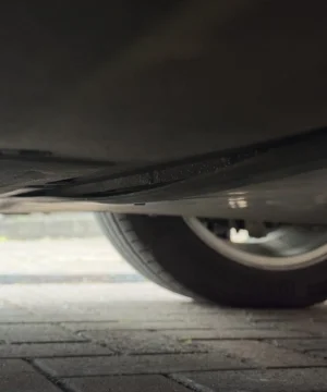

Is this gap enough to complain about for a fix? Car is in for a 2nd service in 2 weeks.

I believe the fix was invented in Australia & adopted by Europe.
I quoted the EU tech bulletin number to my dealer and they're fitting the parts next week, under warranty.
Mine was less than that and I got the fix.
