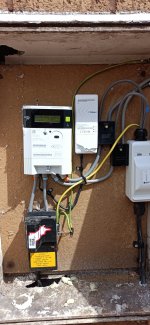

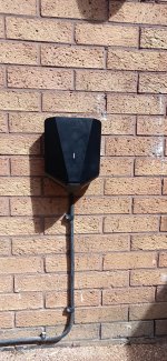

motarbility installed easee charger no car but charger waiting
Looks good. The service head fuse seal has been cut, so if the installer hasn't done so it's worth getting the DNO to come around and fit one. Alternatively, ask your electricity supplier for the cost of an upgrade from 60A and the price for an isolator switch.
