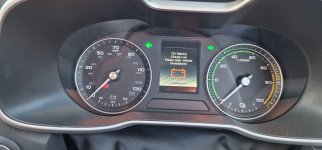

And from what I can tell, the 12V system is shot. After 30 mins with the hazards running, I got this message...a 63Ah battery should not die after 30 mins of minimal current drain.

And from what I can tell, the 12V system is shot. After 30 mins with the hazards running, I got this message...a 63Ah battery should not drain after 30 mins of minimal current drain.
Nope the 12v battery is most likely goosed from some time ago.
I'm wondering if all that is down to a knacked 12v battery....?
It would indicate that 12 volt battery is just not retaining it's charge correctly ?.
Surely the red flag was raised when the battery was on charge for a full 36 hours, which would also indicate the battery was super super low, even after this length of charge, you STILL needed the help of a booster pack as well !.
Thats not right surely ?.
Unless the car is not putting anything back into the battery when it is running of course.
