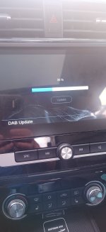

Mayby beacause my radio is blocked 'radio module installation error' it didnt works?? I tried tomorrow first the 12 v batt negative loosse.. en than i tried the update again. Thank you for al your support ?
Mine was in this situation / and after i updated worked again .
Yes ????????
It works

You should format the usb to fat32 or exfat. Next you enter to engineering mode and you select the update dab .
Thanks, was so simple.

Morning all, "Radio Module Disconnected" came up for us the other day, but it's still playing the last station selected.
I've tried to update with the .bin file - but the bar doesn't move (Fat32, tried 2 sticks). Any ideas?
It probably just needs DAB files installing
I have them if you need them
Hi, can you send me that file please? I have the same issue. Thanks.
I saw the file after posting.
What I did:
Extract the zip file to unpack the .BIN file.
Transferred to a USB stick
Put the stick into the phone/tablet USB port(left port)
Open engineering mode on the car screen
Hit version button(top left)
DAB button(bottom right)
Hit update if it doesn't start automatically.
Done!
