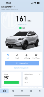

Hi everyone I’m after some help
I’ve seen the range of my long range ZS get lower and lower. Almost a full charge tonight and only showing 160 odd miles. Any ideas I’ve only had it 8 months
I’ve got it booked in but the wait time is a month
Thanks
Many threads on this.
Predicted range is affected by cooler temperatures and previous driving behavior (miles/kWh). I see you are in Blackpool UK, the daily forecast is going down to 3°C over the next week.
You can reset your kms/miles travelled each time you head off with a full charge for an updated prediction. Your predicted range will return during the warmer months.
