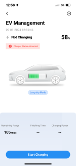

Ok so my FL5LR had its first service Nov. Before this I had not tried a Tesla charger.
There was an VCU update done during the service but I do not have details as to what this was.
My local Tesla Tottenham London has now opened their chargers so have gone to do a test.
I tested with two different chargers using both the app and credit card to initiate the charge.
In both cases it failed to start a charge.
The charger just reported the car was not connecting.
On the car itself it showed an "Electric grid abnormal".
I am going to contact the dealer that did the service see what they say.

That VCU/CCU update is indeed a recall but does not solve the tesla charging issue. You need a separate update for that. Indeed contact the dealer.
