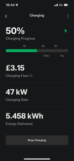

Just did a quick charge at a Tesla charger that had previously failed at. Not rocket speeds but that could be many reasons.
