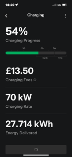

Hi again everyone here so long trip down to London today for the show tomorrow so great time to try some V4 TESLA SUPERCHARGERS with my MG5 trophy.
You may have read in my post above #546 that I tried a Tesla V3 charger last week at the Trafford centre after my software updates and that worked fine plugged in opened the Tesla App and started a charge with no problems.
I said I would try out the newer Tesla V4 units and I did that today but hit a problem at first, so 16 Tesla V4 units near to Luton Airport just off the M1 so I arrived there with only 11% left in the battery having left home on 100% and driving M6 and M1 in terrible conditions 5 degrees temps most of the way with a headwind and driving rain so having now done 175 miles I arrived quite low state of charge much lower than I like to be but wanted to try these Tesla V4 units.
So first of all none of them where fitted with card readers. My son, a Tesla owner and driver, says many are like that. So back to the Tesla App open that up choose the number of the charger and it said plug in and press start charge this I did and the app said charging will start in around 2 minutes but it didn’t !
So I moved to a different stall did the same and after waiting 5 minutes still nothing, so put my thinking cap on and leaving the car plugged in I got back into the car and switched it on put it into ready mode then went in to the infotainment screen for the charge settings pressed start charging and it did less than a minute later.
So it does work I will try some more next week on my return journey home
Les
The picture above shows I put 27.714 kWh into my five and the cost was £13.50 0.49p/kWh so my journey to London around 230 miles in total with that and my charge at home the night before cost around £18.00 so who says running an EV is not cheaper than a ICE vehicle, that would need around 4½ gallons of that smelly stuff saying 50 mpg to do the same trip at around £7.50 per gallon £30.00 I’m I going back to ICE not a chance
Les.
