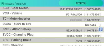

I've done an obd scan using carscanner and the Ezs app meant for the ZS which also seems to pull data from the MG5 (attached)
What I never thought of before now is that I think the evcc/charger is easily visible when the under bonnet cover is removed so I will take a look tomorrow and see if any identifying info can be seen on it
Edit to add landscape version of eZS screenshot with more data - thanks to MickeySw for the advice on that

Ezs doesn't pull as much data, but my earlier attachment from that app is the current firmware versions

If you hold your device in landscape mode eZS shows more info (serial #?), interestingly our FL (Trophy) shows the same EVCC FW rev as yours, I guess that probably means the HW is identical.
That is the conclusion I have come to: the LR EVCC is the same as that fitted to the FL cars with a slightly earlier MG software release. I have got data that indicates that they are the same. The first ref is the base software revision that MG receives from the supplier. The second number 111xxxx is the MG software revision that sits above it. If the supplier software is different then the is a risk of problems but it is not. This is why the pre-fl cars that have been updated work fine. The fact it is EVCC-02 implies that the SR had a EVCC-01 which had a different software base/hardware.
This does mean that there is no need to change the EVCC - "as it is the same as the original". This explains why the pre-fl LR updates have worked. The issue is this bulletin that was sent out stating the EVCC had to be changed which put the dealers is a very difficult spot because they can't take the risk of something going wrong. Some are honest about this others go into denial. I am almost tempted to do that so I could then persue MG through Trading Standards and the small claims court. You fitted a new unit knowingly under false pretenses.
