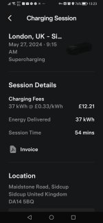

Just charged my MG5 Trophy for 33p/kWh
Thanks for rubbing it in! ?
