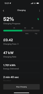

BOOM!!….Dealer wouldn’t tell me what the firmware number was that was uploaded. They told me it completed but did put up an error saying that EVCC needed changing. Clearly not.
That is great news. The point of the EVCC change message is very interesting as it is further confirmation that MG want to fleece PFL LR owners into changing that unit when there is no need. Your unit is compatible with MG4s and is one of the last fitted so there is absolutely no justification to change it.
