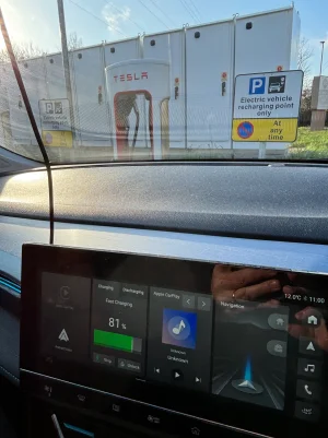

I've managed to update my 72plate FL trophy to work on the Tesla chargers 😃
I'd like to use this post for the following:
  1. Extend my thanks to the folk on this forum for uncovering this problem, finding the solution and documenting it with idiots guides. Very much appreciated.
  2. Give the middle finger to MG for not updating under warranty
  3. Give the middle finger to the dealers for their complete lack of understanding or outright lies. The two stories I got from two different dealers was: £140 but can't guarantee it would work, and £200 because we have to buy a licence from Tesla.
It took longer to queue at the Trafford centre for a test charge than it did updating the car...
One final query....I updated both CCU (for the sc072 12v update thing) and the EVCC. EVCC was spot on, CCU software update was spot on, but SIPPS showed that my car's CCU configuration file was more recent than on MG database (see photo)! I decided not to update the CCU config as didn't really know what I was playing with. There seems to be no change to the charging of my 12v. Has anyone come across this?
