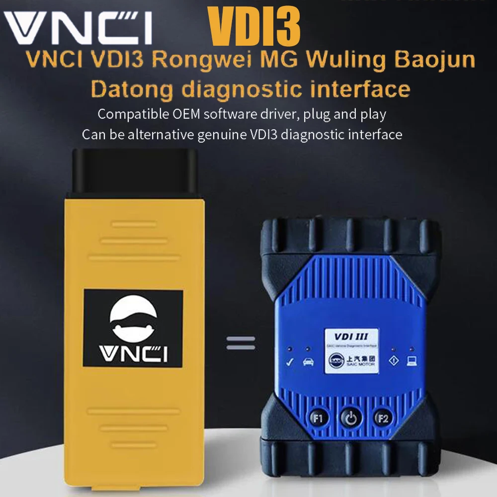

Would you mind sharing the link for the diagnostic interface you bought? Just in my experience buying copies of other marques equivalent the quality can be variable so would be good to buy the same one.
@xblackwolf90, that's great that worked well for you, like you say anything to avoid lining the dealer's pockets for ten minutes work!
This is the one I sent for:
I ordered last Saturday at about 10PM and it arrived today (Sunday) so only a week to get here.
Tip: if you have a bank or credit card that has no foreign transaction fees, pay in USD and it's a bit cheaper. It's £114.53 paying in GBP. Paying in USD it'll be £112. Hardly a huge saving but I'll take it!
For just an EVCC update you'll only need 1 hour access to SIPS as it's a small update. I paid for 24 hours but definitely didn't need it. No need for the battery charger either.
