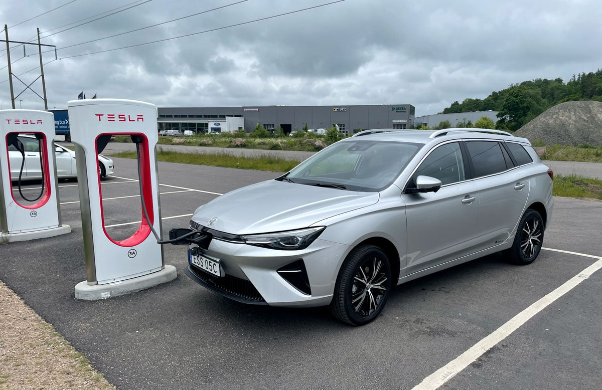

So here it is, my MG5 LR Luxury facelift has received an update of the CCU controller in the car which should make it able to charge at the tesla supercharger, I still need to find some time to test this. At my dealership in the Netherlands they described this as a recall sw update of the CCU. So get your MG to the dealer and request them to update the CCU software, which is NOT the MCU software. @admin, please make this answer stand out in this topic!
Hi @jpvdheijn - have you managed to test yet if your updated CCU now allows charging at a Tesla Supercharger? Many thanks
Hi @franoreilly, the CCU update that had been done did not result in the car charging at the Tesla supercharger. I have contacted my dealer again since in the dutch tweakers topic there are others that have a more recent or updated MG5 that can charge at Tesla. To be continued

Not really new info - but tried the one at Lakeside as happened to be nearby - didn't recognise car

Not sure if any of you have seen the posts by @craggy but he managed to charge his FL MG5 at a Tesla supercharger after getting an update to his charging unit...
An article in Sweden suggests that earlier models do not have the Tesla protocol in software programmed and that MG europe is offering a update to make cars that do not have this yet compatible.
It reads to me that it refers to the early facelift models only because I don't believe Europe had the pre facelift model.
An article in Sweden suggests that earlier models do not have the Tesla protocol in software programmed and that MG Europe is offering a update...
