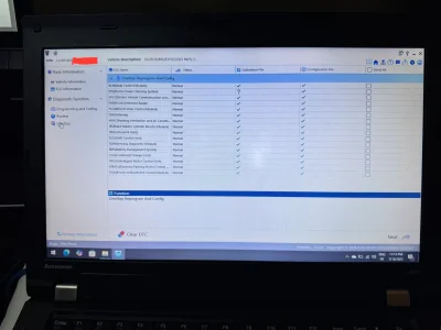

Hello, sorry. I don't understand nothing of cars, can you make a complete tutorial of how to update via sips? Hardware we need to buy, app, etc? Thank you.
