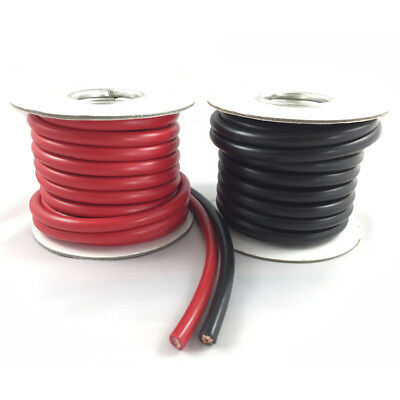

You should be okay with MG ZS EV, though you will reduce your 12V battery life. Also consider that 10 Amps at 240V (2.4kW) through a 12V to 240V inverter would mean your 12V battery would be operating at a continuous 200 Amps ! You are going to need some serious cabling from the battery to your inverter.
If all you want is to run some led lights in your tent and charge up your eBike battery you should be fine. Anything else, then go the approved V2L route.
