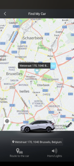

Just out of curiosity decided to see if vehicle had been taken to body shop by using ismart find my vehicle, tells me it's in Brussels and not Warrington ??
