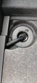

Well merged or not, no answers to what it is (some references to the seal, some to the light clusters idk I’m not messing with it. Booked in to summit garage on 1st. The inflator kit was soaked and if you look in the green bucket (Georges belly) sucked up about a coke cans worth. Can confirm the cheap v2l adapters on eBay will happily power 1200w load no problem - every cloud.
This may explain the foggy rear window! I’d advise all to take the inflator tray out and have a look. The kit is now drying in the house.

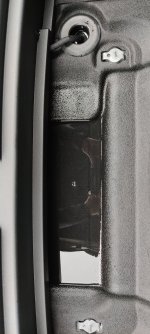

Had some water in the boot, under the tyre repair set. Was almost one liter of water.
Oh dear … looks like we have found a flaw. Wet and dry vac gets a fair chunk out but it appears to be under the felt liner aswell so sucking it out is a must. Urgh
My MG4 SE is letting water get into the boot and filling up the area below the tyre air compressor tray. No sign of how it’s getting in! Dealer can’t book it in for warranty investigation until Jan 24! Anyone had similar experience or found a solution?

Ooh that’s interesting. Since getting the water out with a vac and leaving the toolkit and floor liner aside it has started to dry out. It’s gone from swimming pool to damp though I haven’t washed the car which makes me think it could be as you say water sitting in the boot spoiler (I have an SE so no top spoiler).
