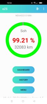

Just returned my 2 year old Mk1 ZS. I charged it to 100% every time via a granny charger at 2.2kw and it never got charged away from home. Sometimes sat for days at 100% without being used as I needed it at a moment's notice for possible long journeys for my business. Battery was degraded by 0.8% so that would be a 4% loss in 10 years. Don't worry about it.

It was a MK1 ZS so I presume it was NMC ? I really do think there is too much concern around battery charging. If I can't charge it and use 100% what's the point ? The BMS will take care of it. I now have an MG Marvel with 70kw battery that I bought outright and intend to use it just the same. If I live 10 years I will report back ??
I thought so, but I haven't been at this long! If an NMC has so little degradation after two years of that, it very much backs up what Euan McTurk is saying in that video about not worrying about it unless you're leaving the car for ages, or leaving it for a week or two more than occasionally.
