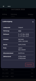

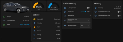

I'm using the python gateway with home assistant, evcc and tibber. Works very well for me!
The python gateway uses mqtt auto discovery, so there is no need to configure some sensors or switches.
BTW:
The developers added some filters and fixes to the mqtt gateways to make everything more reliable. But the http gateway is quiet old (april) and won't get any updates in future.

How much does Tibber charge ?They give you the price from the
Evcc calculates the charging time based on soc and charging current. In my config the wallbox current is 20A, but the MG5 has only 16A. So the time is not so accurate.
I'm using the charging station plugin to wake the gateway for charging.

Hi,
while waiting for my MG to be delivered, I am already busy preparing a charging point at home.
It looks like that you already have the configuration which i have in mind using the lowest prices for charging. But instead of tibber I am using awattar via EPEX integration in HA.
Your HA cards are looking very nice., would love to implement similar in my HA.
Any chance to PM me your cards- & automation files?
BTW: What charging station are you using?
Thanks in advance

At the moment my charging station is a Vestel EVC04, but I ordered a easee lite yesterday.
The EVC04 can't auto-switch from 3 to 1 phase charging, so I think the easee is a little bit better.
My MG5 can charge 32A with 230V or 16A with 400V. So it's a good idea to invest in a 22kW charging station :)
Give me some days to prepare my code.
