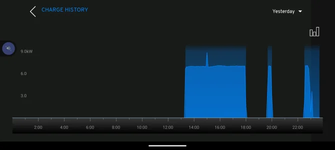

I am not a technical person, so my apologies if this is a stupid question, but is there a way of knowing whether a charge to 100% has balanced the battery or not balanced it?
Most EVSEs will show you how much charge is going into the battery - if you look at mine from last night up to midnight the rate gas dropped down to about 200w from the normal 7kW and that is balancing happening. It can take up to about 40 minutes on the LFP battery.
There are no stupid questions dsr. Yes, as Tight Git says you can check your charging curve map on your charger or car. It will show a gradual reduction in kw's going into the battery from 7kw's gradually down to 1kw & 600w, 300w etc etc until the charge is completed. Mine takes 10-12 mins in total to do this part of the equalisation but can take longer if it hasn't been done for a while. Give it a try. On my ZS I have to drop the state of charge (soc) down to just below 20% soc & get the low battery warning before doing the equalisation charge otherwise the battery management system won't initiate the equalisation charge. On many MG4's & some earlier ZS's apparently you don't need to do that according to some on this forum, but check your owners manual on that. Good luck!
