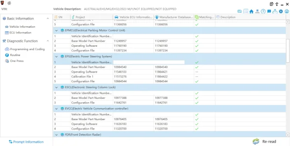

No new 51 updates in AU apart from a new power steering update that it won't let me install, comes up with a EPS (Electric Power Steering) new software version, but when i try apply it it asks for a confirmation code and has a message along the lines of "this is upto date, is the customer actually experiencing issues" which is new to me. anyone else seen this?

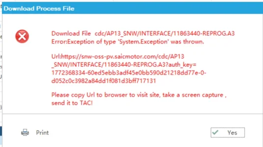

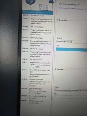

I'm able to establish a connection to my vehicle through SIPS. However, any module that i try to update just errors.
I'm getting "PPF File Run Failed" error and then the process stops with the message "Unknown Error, Please contact TAC. 10"
Have anyone else had similar errors or knows what i'm doing wrong?
I'm also getting several errors when I start the car now. It drives ok, but with multiple system errors. I've disconnected the 12v battery for 20 minutes but that hasn't helped. The errors are ACC, Forward Collision, AEB, Driver Drowsiness and LKA systems. Am I fight thinking these all use the FVCM? Anyone know how I can fix this?

Managed to sort it. I updated the firmware of the VNCI. The FVCM kept failing so I had to use the replacement function to update it. Everything else alsl updated fine after the firmware update. 😀
