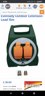

That’s the one I use . Never had a problem
