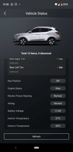

It looks like that on the way the 12v battery went flat (hope it's not a begining of 12v battery issues).
According to the AA guy 7 out of 10 cars with this problem are MG cars 2 out of 7 can be fixed by disconnecting the battery.
