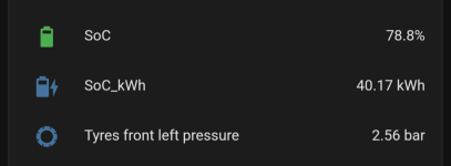

I have SE LR MY23 (64 kWh) and my SoC and SoC_kWh in Home assistant calculates kWh as if I have 51kWh battery.
Can this be fixed so it shows correct value?
Sure, get in touch with me in pvt here on the forum, I'll need some debug info to distinguish that model variant

What do I need to do to give you debug info you need?
0.7.0-rc9 onwards will report 64kWh for MG4 with a low trim level and a configurable SoC target in the app. That's unfortunately the best I can do since MG re-used the same model code between the 51 and the 64 versions
