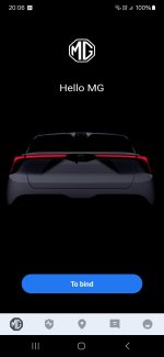

I open the app and get a screen asking me to bind

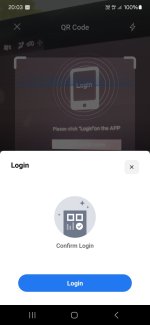

Then I go to user and get a qr code and scan it. I get a button to confirm login which all sounds good. The car also tells me to click the login on the app.
I do that and straight back to the to bind screen.
