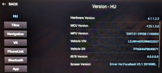

Consensus initially was that R05 was the max for his car. But then I read R11 in Update of an SE SR
With the UK/EU Infotainment software you can access the Engineer menu in the SE (Excite) cars by typing the following code into the car's telephone keypad:
Code:
#*#4479*#*
Maybe give that a try?
And then I realized this isn't working on the SE...aarghh. Sorry for the confusion Decrep.
But if with acc on your car is no longer dropping the speed, you got that update.
No worries, but I haven't tried ACC yet, I'll do so tomorrow.
Code:
#*#4479*#*
Thanks Siteguru,
Next question, where's the telephone keypad? Do I need phone plugged in?
I'm not sure if you need your phone connected (even just by Bluetooth). Press the telephone button on the steering wheel (or on the screen menu) then (if it appears) press the symbol to bring up the number keypad. Once there simply type in the above code - if it is accepted then after releasing the last key the screen should change to show the menu. See my 1100R33 thread for photos of the screens I found.
Press the physical Home button to return to the normal screen.
Ok I'm in version is still saying R05, but there's a lot of other numbers here, are they significant?
They are related to other firmware for systems like lka, BT etc.
We should compare it with others with an AU/NZ SE to see if they are old. Maybe take a picture?

Here's the version pics.
Hope this helps to determine what's going on.
Cheers,
Mike
Mike, hide your VIN or at least partially mask it. It's the ID of your car.
Next step is to ask for other SE owners in NZ/AU to do the same so we can compare.
On the French forum they started collection this data, including updates after a service. Ideally, you could link it to complaints of owners and then see if certain changes actually lead to improvements.
OK I've deleted that pic, I'll repost it without the VIN.
