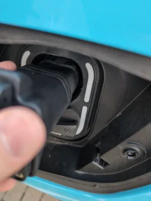

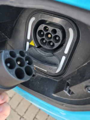

The one I have doesn't fit in the port hence why I need an adapter or another plug.:( Do you have a link?

It's exactly the item you linked to in the OP, as far as I can tell. What is it that doesn't fit? Can you take a photo to show the bit that doesn't fit?
Attached

Oh I see. What you have is type 2 "male" which makes it the same as the charging port on the car, so of course it won't fit. Presumably the one I have that does fit has female sockets. I didn't actually know they made them like the one you have. (Maybe you could plug it into your type 2 charger to turn it into a 3-pin socket if you wanted???)
You may be able to exchange it, but it's not exactly high finance.
The one you have posted a link to is designed to be used plugged into an EV charger rather than the EV or into the car end of a type 2 cable, as it has a Type 2 Male Plug end. A common use case for this would be using a type 2 charger to charge up batteries in an RV, rather than use an EV as a power source.

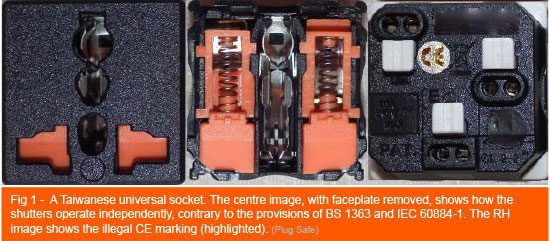

The reason for the lower price is the fact that it has the "universal socket" design. This does not meet UK regs for a socket. A very good write-up of the issues can be found here
I didn't realise they were available without the universal socket (and I didn't realise the universal socket had safety issues). I did get mine from eBay as far as I remember. I've not had any issues with it, but perhaps I should retire it and get one with a proper three-pin socket from Amazon.
The one I ordered last year (not the current eBay link I posted) had 3-pin socket but came with a separate "universal" adaptor; mine was £15 from memory. There are quite a few 3-pin ones on eBay and in many cases, the sellers are the same on eBay and on Amazon...
