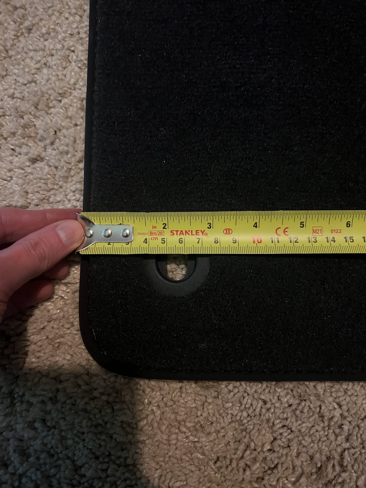

Pictures as requested. First 3 measured from the left to 1st hole, second hole and full size20221106_140251.jpg20221106_140312.jpg20221106_140323.jpg
Now hole to hole
Now clip to back of carpet where they are slightly misaligned

I’m inclined to say it’s the mats that are misaligned not the car based on my photos.
Andy how do yours compare to the photos I posted earlier?

It's a 'fault' with MG not putting them in exactly the same place every time! You can unscrew the carpet clips and reposition them to fit the mats.
Seems the same problem as the undertray, quite a few variables with the car
Andy, pretty much the same dimensions to be honest. I don't have the car to try them in so ?‍♂️. I will sit back and watch if others have the same drivers mat dimensions and if possible they move the floor clips appropriately. I assume all other mats fit just fine, just the drivers one doesn't align?
