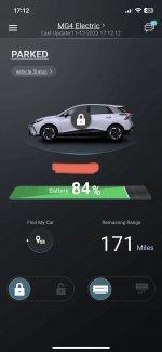

Seriously, can anyone explain this?
It’s easily -1c or lower here right now and and I’ve not got close to this level of range even in much nicer weather (it’s an SE SR)
What mpkwh would it even take to reach 171 miles range from 84% battery??
The driver display is saying I’m getting 2mpkwh.

4 mpkWh would give 171 miles range from 84% battery.
0.84 x 50.8 = 42.672 kWh
171 / 42.672 = 4.007 miles per kWh
Cheers
So begs the question….which is correct?
The GOM that says 171 miles from 84%, or the driver display that won’t budge from 2mpkwh….
It's like the leaf GOM all over again. That was always wildly optimistic. You'll eventually learn how far the car will go for a given percent in different conditions. You can also calculate it yourself using a similar method to what siteguru used.
The formula is: 50.8*(battery%/100) * expected mi/kWh
Actually due to the fortunate value of 50kWh capacity there is an easier way to do it.
Take the battery percentage and halve it then multiply it by the expected mi/kWh for your journey.
So at 70mph you should expect 3 mi/kWh. If you have 60% left you could go 30*3= 90 miles
The Driver display - that's what you are getting at that time* for whatever reason.
