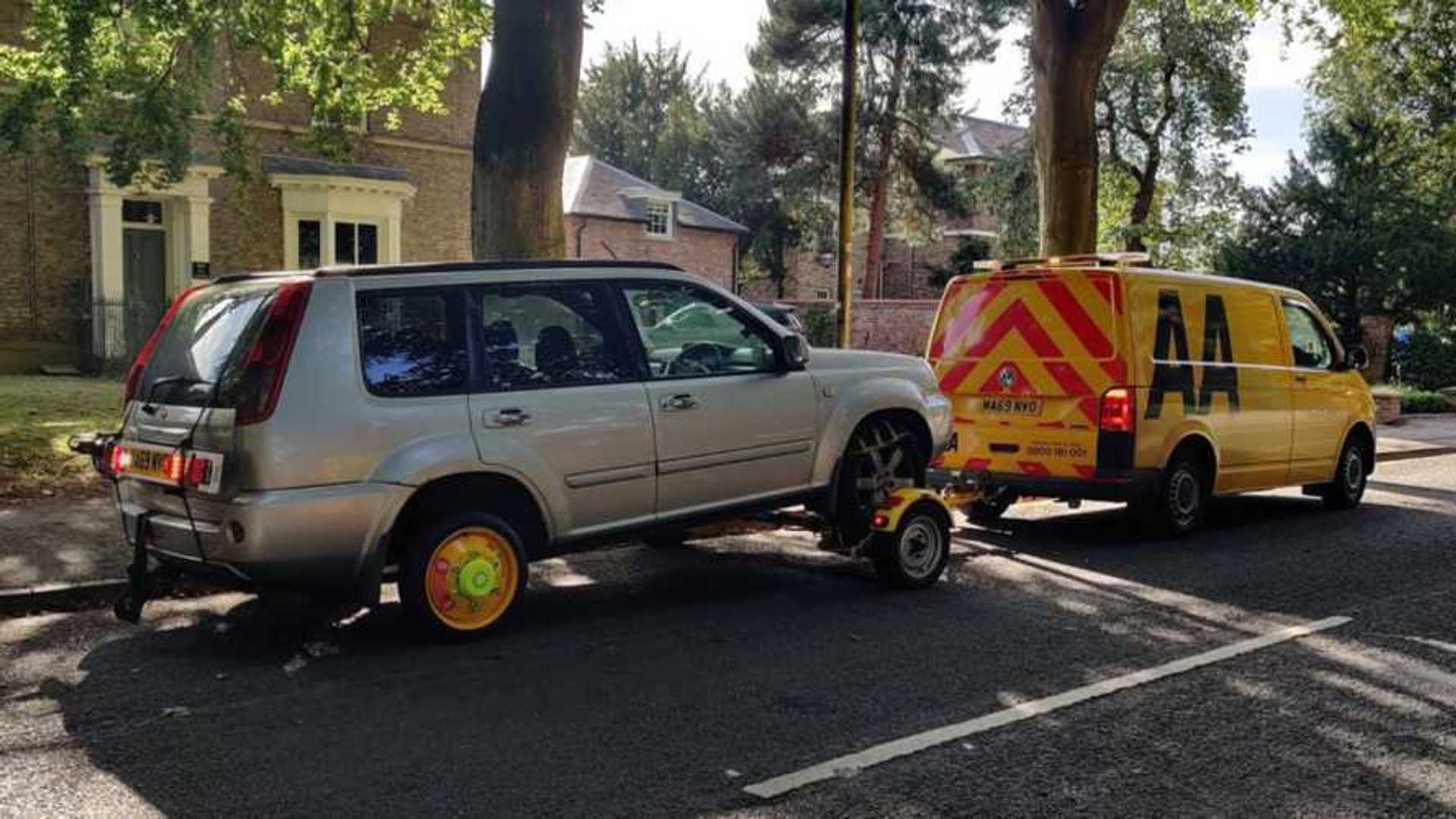

Update - AA man has been. Says it has a little oil leakage, not a lot, but agrees with the advice not to drive. He has booked a recovery tow to the garage in the morning. I said I wasn't sure that you could tow electric cars. He said it would be rear lifted, which would be fine as the car is a rear wheel drive. The manual says this, which I assume backs up what he says:
DO NOT tow the vehicle with any of the driving wheels in contact with the road surface, this will avoid electric drive transmission damage.
I'm still not sure that I am happy with this, as the dealer is 30 minutes drive away. Does anyone with more knowledge and experience than me know if its fine to tow an MG4?!
Yes with the driving wheels off the ground and not turning the motor it is fine. The problem with a normal ground tow is that even in N the motor is not disconnected from the drive wheels which could cause damage. With it rear lifted and steering locked all should be fine as the drive wheels are not active and front wheels should be free spinning. I suspect car could even be driven with no damage to be honest but the dealership probably wants to err on the side of caution. Also if you can't trust the AA expertise where does that leave us? All Wheel drive need a lift and new wheels fitted to the remaining wheels which are free spinning. This can also be used on ev's which have locked brakes on the non driving wheels
Yes with the driving wheels off the ground and not turning the motor it is fine. The problem with a normal ground tow is that even in N the motor is not disconnected from the drive wheels which could cause damage. With it rear lifted and steering locked, no brakes applied all should be fine as the drive wheels are not active. I suspect car could even be driven with no damage to be honest but the dealership probably wants to err on the side of caution. Also if you can't trust the AA expertise where does that leave us? All Wheel drive need a lift and new wheels fitted to the remaining wheels which are free spinning. This can also be used on ev's which have locked brakes on the non driving wheels
Thanks. I guess I've been made nervous by reading articles suggesting that you should never tow electric cars as neutral on an electric is not the same as on an ice, as the electric motor is never fully disengaged, and also there might be an issue with the regen brakes. Also I'm nervous about car damage to my new car, especially as the front of the car is quite low to the ground!
I agree with you about driving to the dealer, but I'm kind of snookered with that as the dealer and the AA has advised me against this.
I would hope the lift should not be as steep an angle as to affect the clearance at the front too much...or now rear whilst being towed...and potentially cause damage. As I said if you cannot trust the AA to tow ?‍♂️

Wouldn't touch one with a bargepole but if you do you need the car active in N with you inside it and auto hold off as the instructions state...and then stand back and admire your swirly paintwork afterwards
It's the same problem with auto gearboxes. The driven wheels have to be suspended or as in a bus's case the half shafts are removed before being towed by the big truck with the yellow flashing lights.
