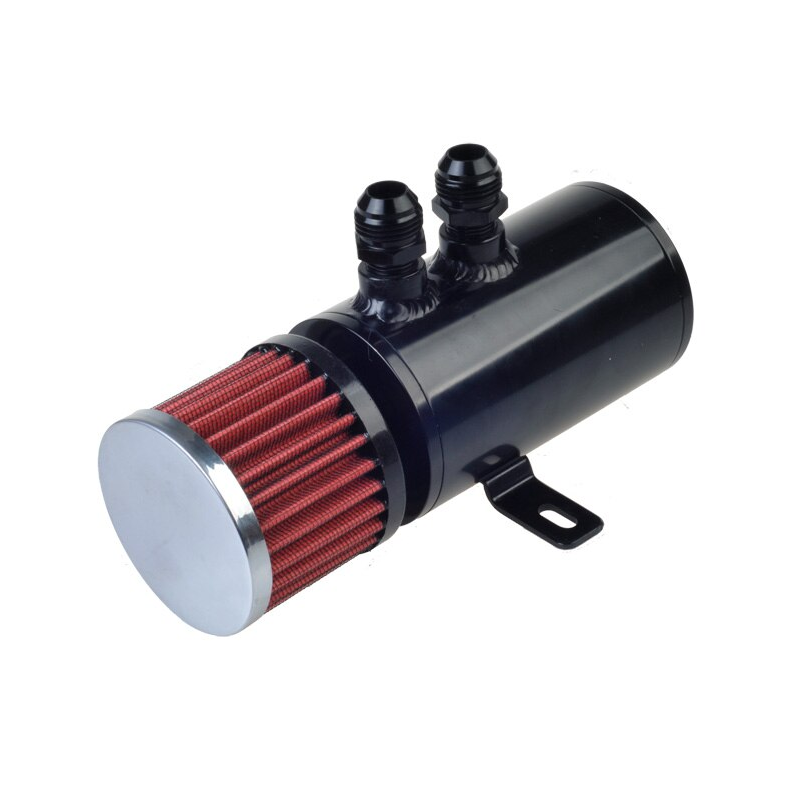

Good morning Macadoodle.
I am following your work closely and I admire your persistence in solving the problem of oil leaks from the gearbox/differential block breather. But I have a suggestion: why not implement this type of breather which is used in competition on gearboxes?

Thanks for the suggestion Gilles. To be honest now I've fitted a simple short tube to the side of the assembly via an adaptor screwed into the filling hole, I've not had any further leaks.
I'm going to refine it further with the correct brass 90 degree connector and shorten the pipe so it runs vertically straight from the outlet to just under the boot floor.
The change to side mounting was the critical thing it would seem, everything just worked after that :)
