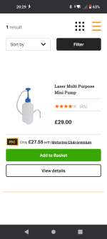

2 Can you give me a picture or a link to the laser pump you say you got from Halfords to help with refilling I have look on there website but found nothing.

Halfords pump .
