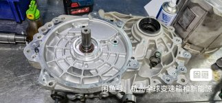

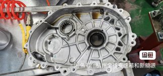

MG5 EV gearbox (Roewe Ei5 actually, the Chinese market MG5 EV)
From a second hand website.
image_editor_1680722624996.jpgimage_editor_1680722607723.jpgimage_editor_1680722594111.jpgimage_editor_1680722585772.jpgimage_editor_1680722570272.jpgimage_editor_1680722526831.jpg

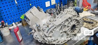

Here is another second hand Roewe Ei5
Including motor, gearbox and control unit.
image_editor_1680722979586.jpgimage_editor_1680722992602.jpgimage_editor_1680723002596.jpgimage_editor_1680723012396.jpgimage_editor_1680723020404.jpgimage_editor_1680723031127.jpgimage_editor_1680723051097.jpg

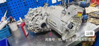

someone claims this is the complete unit from MG4 (MG Mulan)
I believe this is the one actually for MG4, the above one could be the same unit but front mounted version (another SAIC car used same motor at front axle)
Front axle mounted version, same motor as MG4.
Not sure whether the gerabox is the same or not. The control unit should be the same due to the same motor.

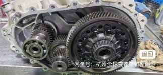

image_editor_1680725278476.jpgimage_editor_1680725270600.jpgimage_editor_1680725293579.jpgimage_editor_1680725285997.jpgimage_editor_1680725310121.jpgimage_editor_1680725302368.jpg
Interesting... thanks for that. Does look very familiar, only the drain plug being on the other side of the casing being obvious to me.
Note that there is an oil shield protecting the breather outlet in the exact same spot as the 4's unit.
Surely the 4 has the same casting... or does it. The mystery deepens....
Perhaps the first batch didn't for some reason and the 2023 ones do.
It would be a truly bizarre thing to omit, why would they expect anything other than trouble by doing so ?
I'm going to investigate next time I'm under there though, should be an easy enough thing to feel with a screwdriver now we know what we're looking for.
Edit- Notice how the shield is shaped on its right side so it dribbles the oil wash it will receive from the big ring gear down to lubricate the motor output cog.
That cog will be spinning at maybe 10,000 rpm at a fast cruise, and it's located really close to the breather. Would be my main suspect and might explain why me moving the breather to a spot on the other end ( and on the side ) of the box cured the problem.
